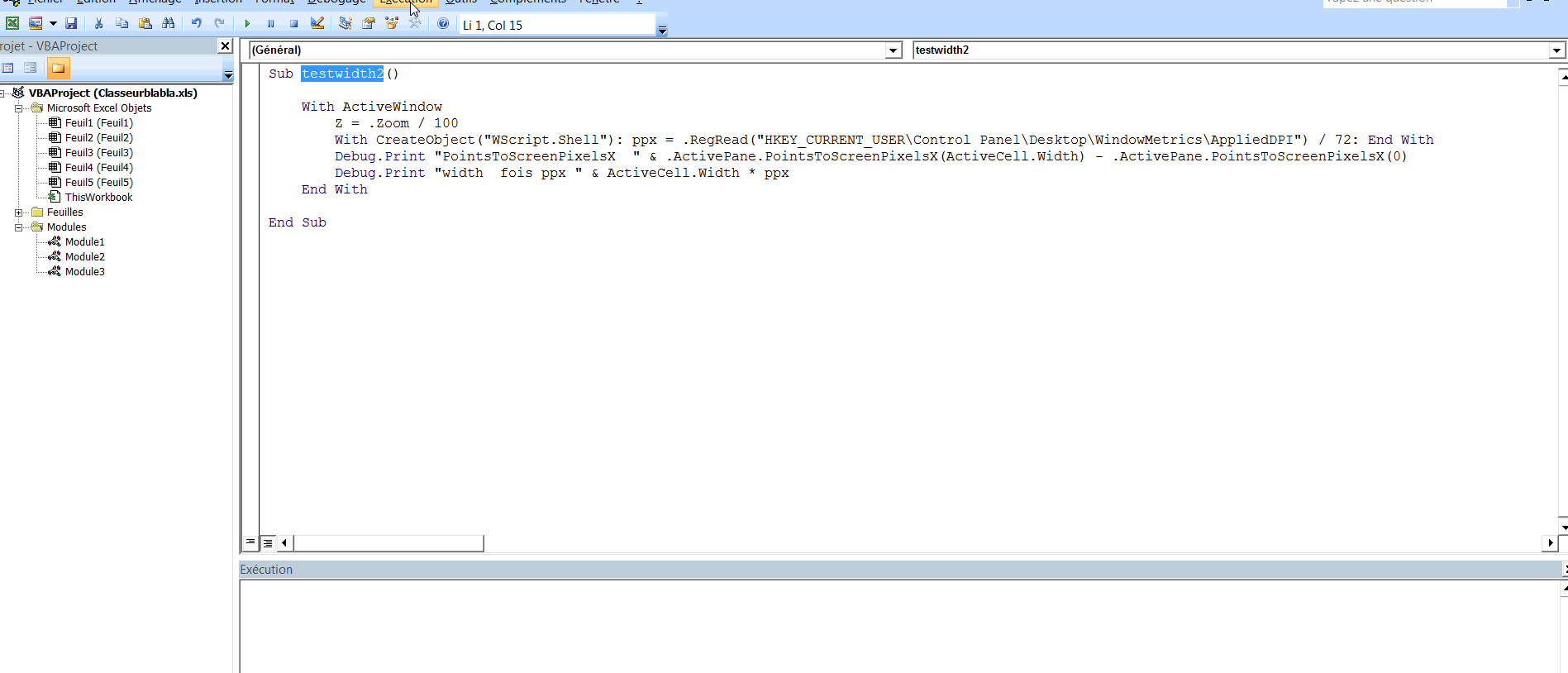

  11. #871
    cuisiniste
    Avril 2009
    15 379
    Activité : cuisiniste
    Secteur : Bâtiment
    Inscription : Avril 2009
    Messages : 15 379
    Points : 12 075
    12 075
    Par défaut re
    ceci: chez moi place le userform nikel sauf que j'ai enlevé l'ajustement donc trop court
    Sub testwidth2()
        With ActiveWindow
            Z = .Zoom / 100
            With CreateObject("WScript.Shell"): ppx = .RegRead("HKEY_CURRENT_USER\Control Panel\Desktop\WindowMetrics\AppliedDPI") / 72: End With
            'ppx = (ActiveWindow.ActivePane.PointsToScreenPixelsX([A1:B1].Width) - ActiveWindow.ActivePane.PointsToScreenPixelsX(0)) / [A1:B1].Width / Z
            x = (.ActivePane.PointsToScreenPixelsX(ActiveCell.Left) + 1) / ppx
            x2 = (.ActivePane.PointsToScreenPixelsX(Range(Cells(1, 1), ActiveCell).Width - ActiveCell.Width)) / ppx
            Y = .ActivePane.PointsToScreenPixelsY(ActiveCell.Top) / ppx
        End With
        With UserForm1
            plus = Round(.Width - .InsideWidth)
            Debug.Print plus
            .Show 0
            .Left = x2 + 4    ' plus
            .Top = Y + 4    'plus
        End With
    End Sub
    ton test que lance tout de suite apres
    Private Enum DWMWINDOWATTRIBUTE
        DWMWA_NCRENDERING_ENABLED = 1
        DWMWA_NCRENDERING_POLICY
        DWMWA_TRANSITIONS_FORCEDISABLED
        DWMWA_ALLOW_NCPAINT
        DWMWA_CAPTION_BUTTON_BOUNDS
        DWMWA_NONCLIENT_RTL_LAYOUT
        DWMWA_FORCE_ICONIC_REPRESENTATION
        DWMWA_FLIP3D_POLICY
        DWMWA_EXTENDED_FRAME_BOUNDS
        DWMWA_LAST
    End Enum
    Private Type RECT
           Left As Long
           Top As Long
           Right As Long
           Bottom As Long
    End Type
    Private Declare Function DwmGetWindowAttribute Lib "dwmapi.dll" (ByVal hwnd As Long, ByVal dwAttribute As Long, ByRef pvAttribute As Any, ByVal cbAttribute As Long) As Long
    Public Sub testons_donc()
        Dim toto As RECT ' ----->> le rectangle étendu que l'on veut extraire (aero, donc)
          ' UserForm1.Show 0
        hwndusf = FindWindow(vbNullString, UserForm1.Caption)
        titi = DwmGetWindowAttribute(hwndusf, DWMWA_EXTENDED_FRAME_BOUNDS, toto, LenB(toto))
        x = (ActiveWindow.ActivePane.PointsToScreenPixelsX(ActiveCell.Left) + 1)
        MsgBox toto.Left & vbCrLf & toto.Top & vbCrLf & x  '--->> puisque toto est un rectangle typé comme la structure RECT.
    End Sub
    résultât
    Nom : Capture.JPG
Affichages : 248
Taille : 83,2 Ko
    sauf que chez moi 6 c'est 2 de trop
    edit oupss!! n
    on c'est presque bon la différence de 7 est en pixel donc / par ppx on obtiens exactement !!!!!!ce que j'obtiens avec usf.width-usf.insidewidth

    puré même ca il faut que je te montre hein
    t a rien pigé a Windows 7 tu ne fait que supputer
    Sub testwidth2()
        With ActiveWindow
            Z = .Zoom / 100
            Debug.Print "PointsToScreenPixelsX  " & .ActivePane.PointsToScreenPixelsX(ActiveCell.Width) - .ActivePane.PointsToScreenPixelsX(0)
            Debug.Print "width  fois ppx " & ActiveCell.Width * ppx
        End With
    End Sub
    Nom : demo9.gif
Affichages : 209
Taille : 97,2 Ko
    sincèrement jacques arrêtes tes connerie w7 et certainement les supérieurs tant pige pas une miette
    commence d'abords par t'en servir après tu pourra affirmer quoi que se soit
