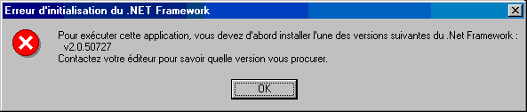

    Concernant le .net framework, l'erreur apparait seulement lorsque je lance l'exe sur un autre PC (càd pas celui où je développe, et où VC++ n'est pas installé).
    Voir fenêtre d'erreur en PJ
    Je travaille avec des microcontrôleurs PIC de chez Microchip. Microchip donne des exemples de programmes écrits VC++ pour tester une communication USB entre le microcontrôleur et le PC. Dans un readme ils parlent de ce problème du .net framework :
    Programs built in the Microsoft Visual Studio .NET languages normally require a
    .NET framework redistributable pacakge to be installed on the PC before they can be run.
    The GenericHIDSimpleDemo.exe and HID PnP demo.exe programs were written in
    Microsoft Visual C++ 2005 Express Edition. These programs require .NET framework version
    2.0 or later installed in order to run.
    The GenericHIDDLLSimpleDemo.exe program was written in Microsoft Visual C++ 2008 Express Edition.
    This demo requires .NET framework version 3.5 or newer to run.
    If you do not have a new enough .NET framework redistributable installed, a non-descript error
    message will occur when trying to launch the executable, and the program will not open. The
    .NET framework v3.5 redistributable is currently (13 July 2009) available at:
    http://www.microsoft.com/downloads/d...displaylang=en
    You may already have the .NET framework installed on your PC, especially if you have already installed
    other applications which were built with one of the Visual Studio .NET languages. Users of Windows Vista
    do not need to install the .NET framework to run Visual Studio .NET 2005 based programs, as the v2.0
    redistributable already comes pre-installed as part of the OS. However, in order to run the Visual Sudio
    .NET 2008 based programs, it will still be necessary to obtain and install the v3.5 redistributable,
    if it has not already been installed.
    These demos programs can be modified and rebuilt using Microsoft Visual C++ 2008 Express Edition.
    Microsoft currently distributes this development environment free, and it can be obtained from
    http://www.microsoft.com/express/download/default.aspx. (Microsoft Visual C++ 2005 express
    edition is no longer available for download, but 2008 edition can upgrade the 2005 based projects).

    Bon, vu la suite du message, je pense que du C# / WPF serait le plus pratique, vu que tes exemples semblent être réalisés sur .NET pour la communication PIC. Mais cela peut aussi être du code C++/CLI, faudrait voir un bout de code pour s'en assurer.
    Attention cependant : il est POSSIBLE (mais pas obligatoire) que tu aie besoin de la version "normale" de Visual Studio (payante, donc) pour certaines fonctions : l'exemple le plus marquant, c'est qu'il est impossible de développer en utilisant les MFC avec la version Express. Je préfère te prévenir à l'avance...
    Citation Envoyé par thom314 Voir le message
    Il suffit d'installer le framework .NET pour résoudre ce problème, c'est un setup disponible sur le site Microsoft. Tu pourras éventuellement (même si c'est assez gros) le fournir avec ton exécutable si nécessaire, en installation optionnelle bien entendu.
